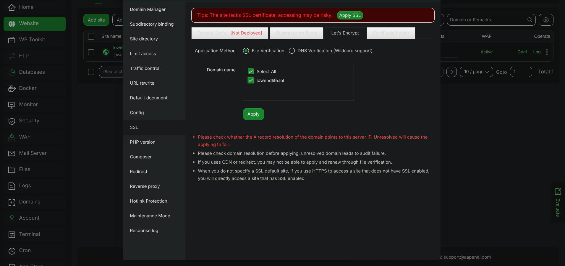

As shown in @nwnuyhs' video I successfully used aapanel to issue the SSL certificate. Chrome now shows a secure connection.
Here is a screenshot of the beginning of the SSL certificate issuance inside aapanel:

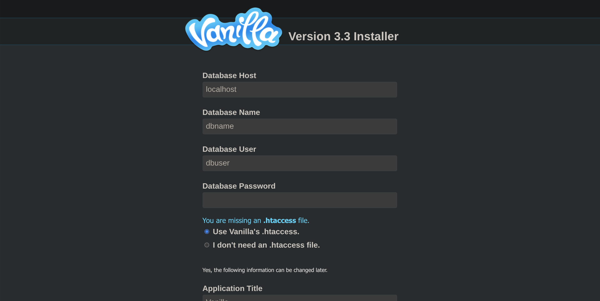

Reloading https://site_name.xxx in Chrome gave me progress--an error message from the Vanilla Version 3.3 installer telling me:
Rather than changing ownership of all the files, which might be the correct fix, let's just fix these two errors and see which errors are next. /s
So now I see the Vanilla 3.1 installer.

Please see this datebase config @Not_Oles
@nwnuyhs
Great! Thanks! I am in now, as you can see.
There seemed to be two problems which now are fixed. First, when set up the database originally, I think the name I originally gave was 18 characters, which might have been a couple of characters too long. I think the name was truncated at 16 characters, without me realizing what had happened.
Second, when I cut and pasted the information from the aapanel -- exactly as shown in your very helpful screenshot above -- somehow a space was added following the database name. Thank you @nwnuyhs very much! Shishi!
