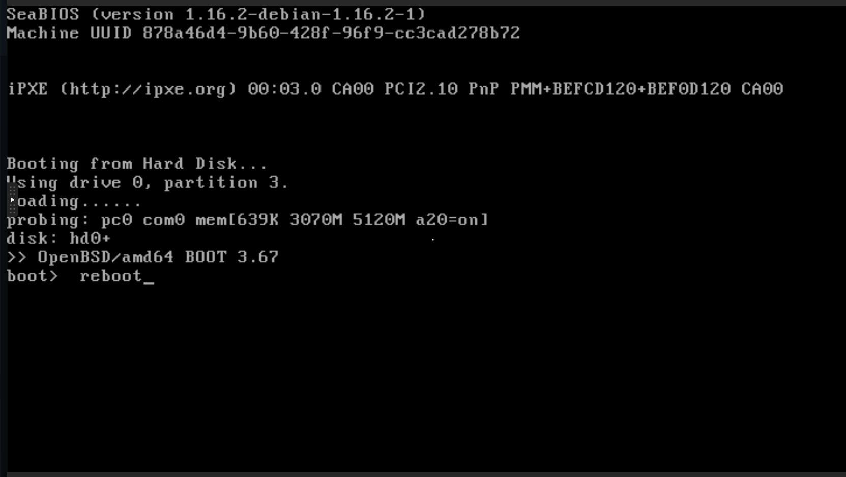

Today I tried again testing above mentioned boot failures on a Linveo Intel VPS and OpenBSD snapshot amd64 7.9-beta.
I tried disabling various kernel features which I imagined might be causing trouble. I tried both the bsd and bsd.rd kernels.
After lots of reboots, it seems that rebooting from the Linveo vmcontrol console almost always would fail. This succeeded twice in a few dozen tries over a period of several days.
What seems to work more reliably ( = hasn't yet failed) was to enable web VNC, reboot from the Linveo vmcontrol panel, watch the boot fail inside the VNC console, and then
(1) reboot again from the Linveo vmcontrol panel with VNC console running
(2) type a space into the VNC console to stop the boot process (see screenshot below)
(3) reboot from inside the VNC console (without involving the Linveo vmcontrol panel) (see screenshot below)
(4) let the reboot proceed normally (don't type anything next time the boot> prompt appears).
So far . . . the above procedure seems to give a reliable boot:
Why? What is happening here?
OpenBSD's man 8 boot_amd64 at https://man.openbsd.org/OpenBSD-5.9/boot_amd64.8 makes a distinction between cold and warm starts. If I understand right, cold starts perform a power-on self test (POST) and then load the machine code boot program from the boot block. Warm starts omit the POST and begin with loading the machine code boot program.
It's clear from the description of the header the OpenBSD man 8 boot page at https://man.openbsd.org/OpenBSD-5.9/boot.8 that the reboot inside VNC in the above screenshot, which shows the same header as the man page, is happening inside step 6 of the boot program:
> >> OpenBSD/amd64 BOOT [x.xx]> boot>Could it be that the difference between the reboots from the vmcontrol web interface and the reboots from inside the VNC console are respectively cold versus warm starts? Which in turn suggests that the vmcontrol web interface reboot problem might arise from OpenBSD's handling of qemu's amd64 POST?
