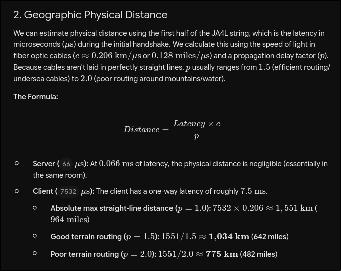

    Discovered servers can deduce how far you are based on latency based on the "ja4l_c": "7532_56" factor - correct answer for me is 844 km which is pretty much bang in the middle of the estimate:
