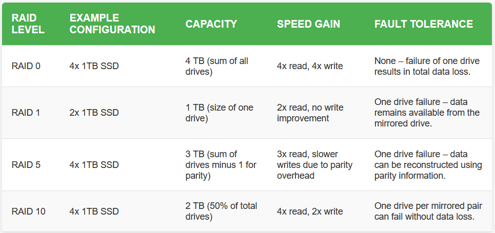

    Yes, the hardware did improve but I was stuck on the following mindset:
    • 1 disk = full write speed
    • 2 disks = 1/2 write speed (without controller)
    • 4 disks = 1/4 write speed (without controller)
    However if we consider the current multi disk servers we have, writing to 1 disk does not affect the other disks. So the only issue is calculating the parity, but that's nothing with our current CPUs. So this makes more sense (do correct me if I'm wrong):
    • 2 disks = full write speed x2 (maybe a little bit less)
    • 4 disks = full write speed x4 (maybe a bit less)
    So with RAID with 4 disks (as per the link on the site):
  • Is anyone even doing hardware RAID anymore? I get the sense that everyone moved to software because it is less of a mess on hardware failure (specifically the controller)
