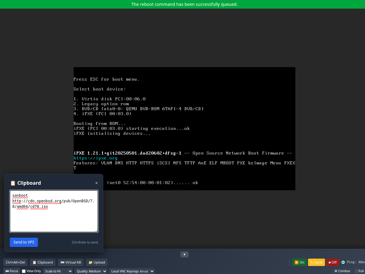

Then get ready to catch the reboot aand start pressing escape in the html5 vnc console:
bsd vps
You will need to catch the ctrl+b option to drop you into the IPXE shell, like the above image shows, if you have DHCP enabled, just type dhcp and press enter; otherwise, you will need to configure your network at this stage, for example:
set net0/ip 192.168.1.123
set net0/netmask 255.255.255.0
set net0/gateway 192.168.1.1
set dns 8.8.8.8
ifopen net0

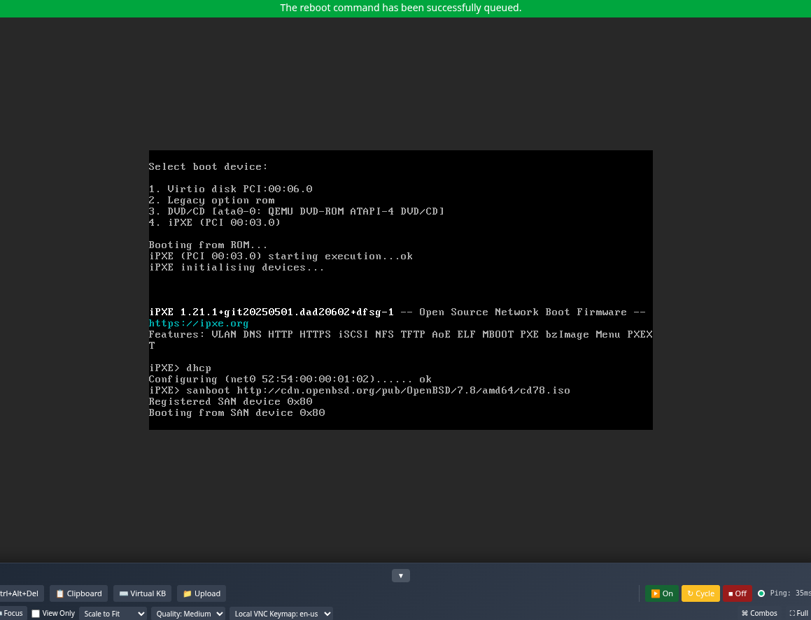

The ipxe shell should now have internet access, so we can pull the cd78.iso
sanboot http://cdn.openbsd.org/pub/OpenBSD/7.8/amd64/cd78.iso
bsd vps ipxe install
Let that run for a bit, if you dont have dhcp you will need to enter the network details again otherise dhcp will sort that out for you, and you will eventually get to the install options:
bsd ipxe install

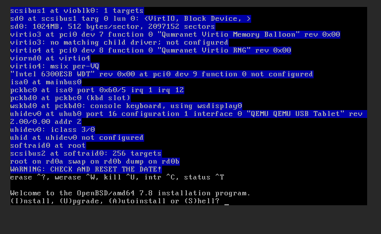

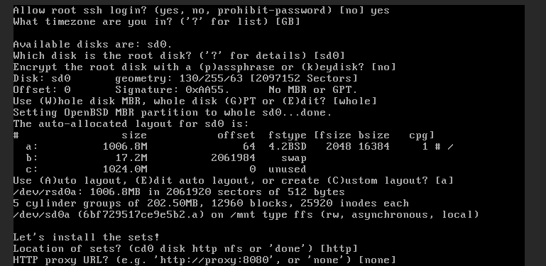

Now select (I)nstall and run through the obvious options for ssh, user password etc, in most cases the defaults are fine but I will assume you have some clue about them if you are even attempting this, I used an auto disk layout for speed.
bsd ipxe install
Select [http] (also the default) for sets.

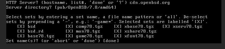

And when it prompts for an HTTP Server, use cdn.openbsd.org
openbsd ipxe install vps

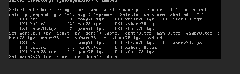

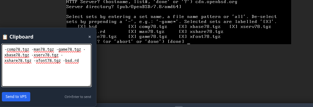

Select the sets for a minimal install, deselect everything that is not needed:
-comp78.tgz -man78.tgz -game78.tgz -xbase78.tgz -xserv78.tgz -xshare78.tgz -xfont78.tgz -bsd.rd

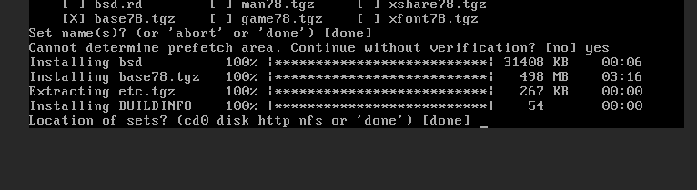

You will see a prompt about the prefetch area; the default is no, type yes
openbsd ipxe kvm vps install
Now its going to pull the sets and then ask you if you want any more sets, the default [done] option is fine.

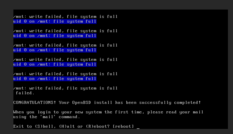

The install will finish up, you will see a load of warnings about /mnt file system is full, it's fine, just run syspatch after first boot a few times, you can now reboot, and enjoy :)
