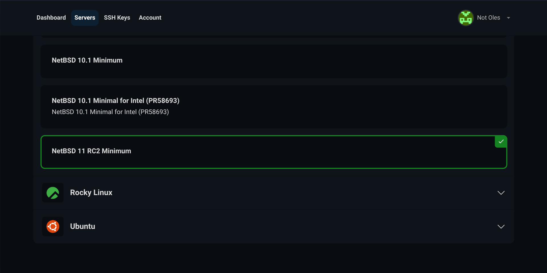

  • @oloke said: However the installation from the official CD is not too hard nowadays.
    Thanks for explanations. I have used openBSD in the past with linveo, and also couple more providers here, i just needed to try and run 2 scripts (one python and one sh) to see if they work on openBSD and to fix them if they dont. So i wanted to just install from template and test , fix and forget. I did this on TierHive thanks to cmeerw to pointing out, as i have still credits left :)
  • @cmeerw said:
    @linveo I have created a NetBSD 11.0 RC4 image
    Actually, updated that 11.0 RC4 image (@linveo) now to fix the postfix config issue in RC4. The image now also creates the swap partition on first boot (depending on system memory and disk space).

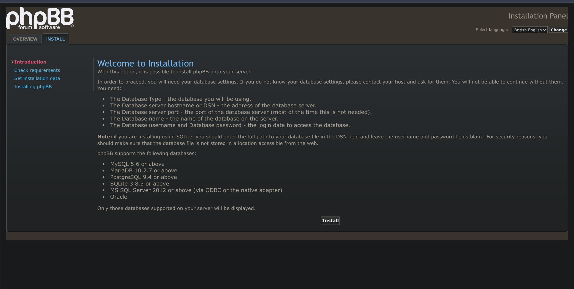

    People recently have mentioned phpBB, so I thought it might be fun to try compiling PHP and using Lighttpd run the phpBB HEAD out of Github. That also seems to have worked, at least up to serving the HTML installer page, which is where I am now.
    When compiling the php-gd extension there were a lot of dependencies which also have to be compiled if they are not already installed, including Python, Rust, LLVM, cmake, plus quite a few more, which took quite awhile. Those wanting a fast compile and install might consider temporarily skipping php-gd.
    Before too long I might again try the latest Vanilla. Or something else that is more simple, just for fun. Ideas?
    If anyone interested in phpBB, Vanilla, or Lighttpd wants to try something together with me, please let me know.
