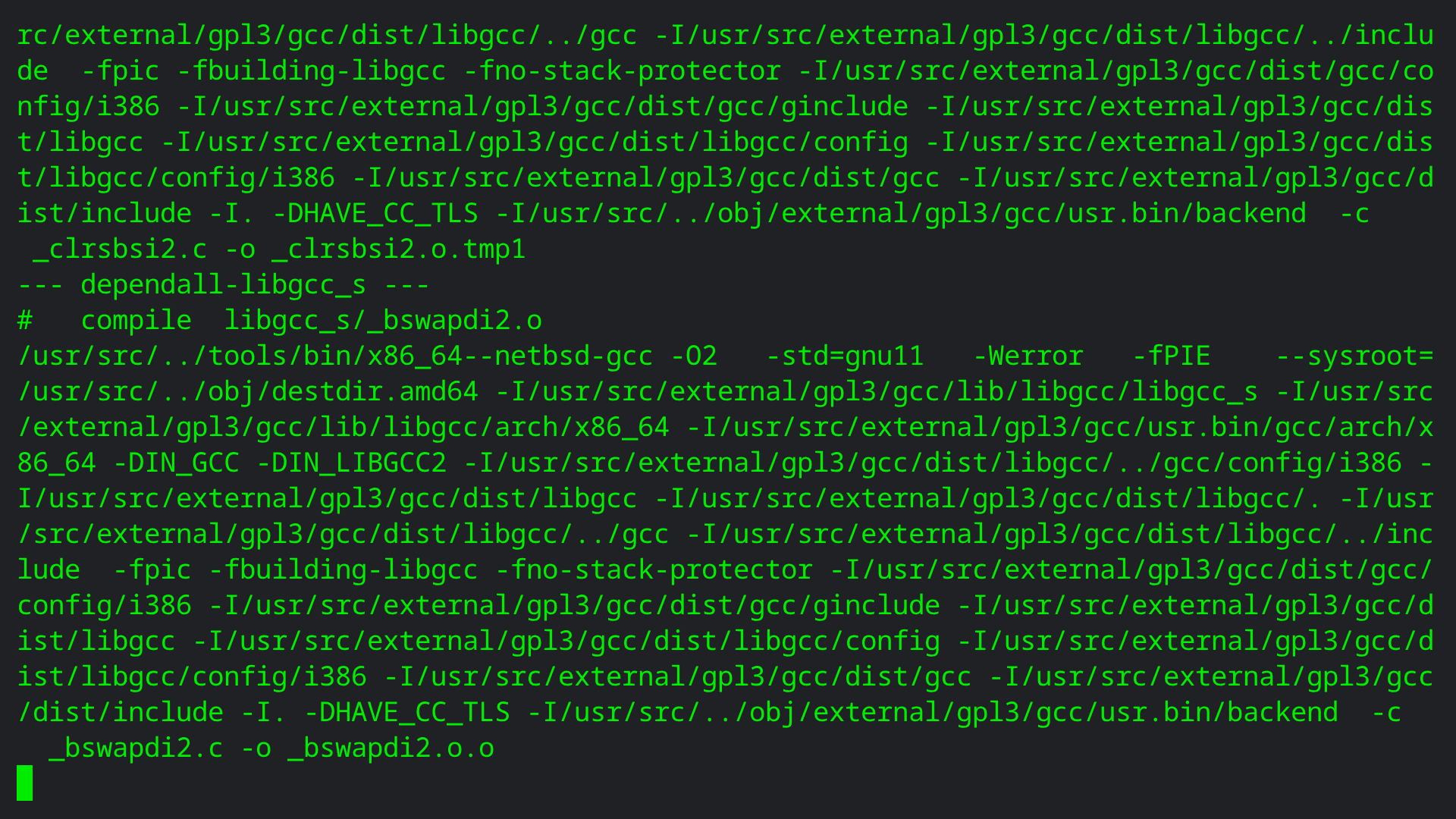

  • checking whether vasprintf is declared... yes
    --- configure-gas ---
    checking for bison... /usr/src/../tools/bin/nbyacc
    checking for flex... /usr/src/../tools/bin/nblex
    checking lex output file root... lex.yy
    --- configure-libiberty ---
    checking whether snprintf is declared... yes
    checking whether vsnprintf is declared... yes
    checking whether calloc is declared... yes
    checking whether getenv is declared... yes
    checking whether getopt is declared... yes
    checking whether malloc is declared... yes
    checking whether realloc is declared... yes
    checking lex library... -lfl
    checking whether sbrk is declared... yes
    checking whether strtol is declared... yes
    checking whether strtoul is declared... yes
    checking whether yytext is a pointer... yes
    checking whether NLS is requested... no
    checking whether strtoll is declared... yes
    checking for msgfmt... /usr/bin/msgfmt
    checking for gmsgfmt... /usr/bin/msgfmt
    checking for xgettext... /usr/bin/xgettext
    checking for msgmerge... /usr/bin/msgmerge
    checking for ld used by GCC... ld
    checking if the linker (ld) is GNU ld... yes
    checking for shared library run path origin... done
    checking whether strtoull is declared... yes
    checking for CFPreferencesCopyAppValue... no
    checking whether strverscmp is declared... no
    checking for CFLocaleCopyPreferredLanguages... no
    checking whether to use NLS... no
    checking whether to enable maintainer-specific portions of Makefiles... no
    checking for memory.h... (cached) yes
    checking whether strnlen is declared... yes
    checking for sys/stat.h... (cached) yes
    checking for sys/types.h... (cached) yes
    checking for unistd.h... (cached) yes
    checking whether canonicalize_file_name must be declared... yes
    checking whether compiling a cross-assembler... yes
    checking for strsignal... yes
    checking for LC_MESSAGES... yes
    checking for working assert macro... yes
    checking for a known getopt prototype in unistd.h... yes
    checking whether declaration is required for environ... yes
    checking whether declaration is required for ffs... no
    checking for SHA1 HW acceleration support... x86 SHA1
    checking for stdlib.h... (cached) yes
    checking for sys/param.h... (cached) yes
    checking for getpagesize... (cached) yes
    checking whether mempcpy is declared... yes
    checking for working mmap... yes
    checking whether stpcpy is declared... yes
    checking for x86_64-unknown-netbsd11.99-pkg-config... no
    checking for pkg-config... /usr/pkg/bin/pkg-config
    checking pkg-config is at least version 0.9.0... yes
    checking for working strncmp... yes
    checking for struct stat.st_mtim.tv_sec in sys/stat.h... yes
    configure: updating cache ./config.cache
    configure: creating ./config.status
    checking for struct stat.st_mtim.tv_nsec in sys/stat.h... yes
    config.status: creating Makefile
    checking that generated files are newer than configure... done
    config.status: creating config.h
    config.status: executing default commands
    --- configure-binutils ---
    mkdir ./binutils
    Configuring in ./binutils
    configure: creating cache ./config.cache
    Happy Sunday! Yet again rebuilding NetBSD-current on a kindly donated, fast Linveo Ryzen VPS!
    Does anyone want to join, get a shell account on this excellent VPS?
    Best wishes!
    Tom

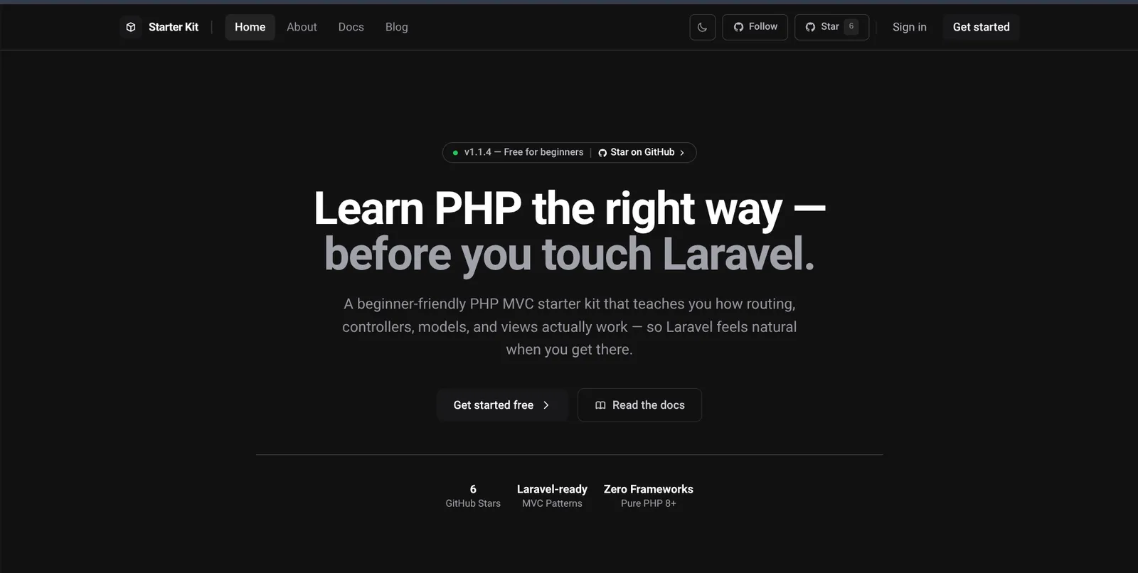

    netbsd$ git clone https://github.com/rodrigomarcelo643/vanilla-php-mvc-starterkit.git
    Cloning into 'vanilla-php-mvc-starterkit'...

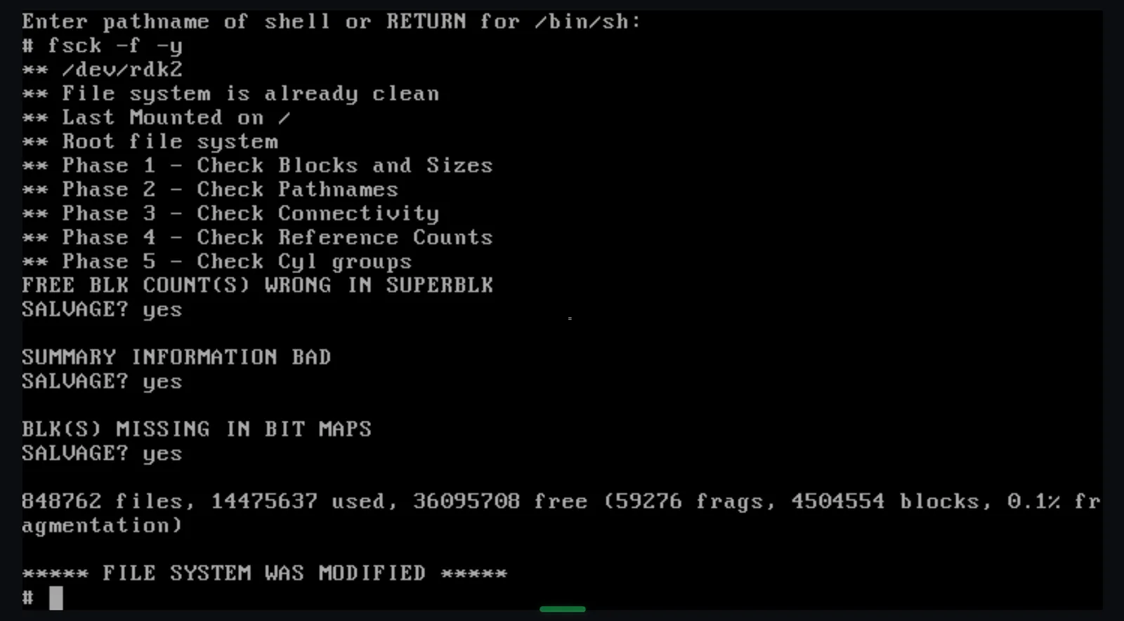

    Interesting day today! NetBSD pkgsrc builds seemed to break while pkg_rolling-replace was compiling Lynx.
    There was an interesting entry in /var/log/messages:
    Oct 4 21:50:19 netbsd /netbsd: [ 5.7789064] ffs_wapbl_replay_finish: /: unable to cleanup inode 3306969
    A reboot into single user mode, and single user fsck seemed to fix the issue.
    Normal reboot succeeded following the single user fsck. Shut down again for backup. Reboot after backup looked good:
    Last login: Mon Oct  5 00:31:24 2026 from xxx.xxx.xxx.xxx

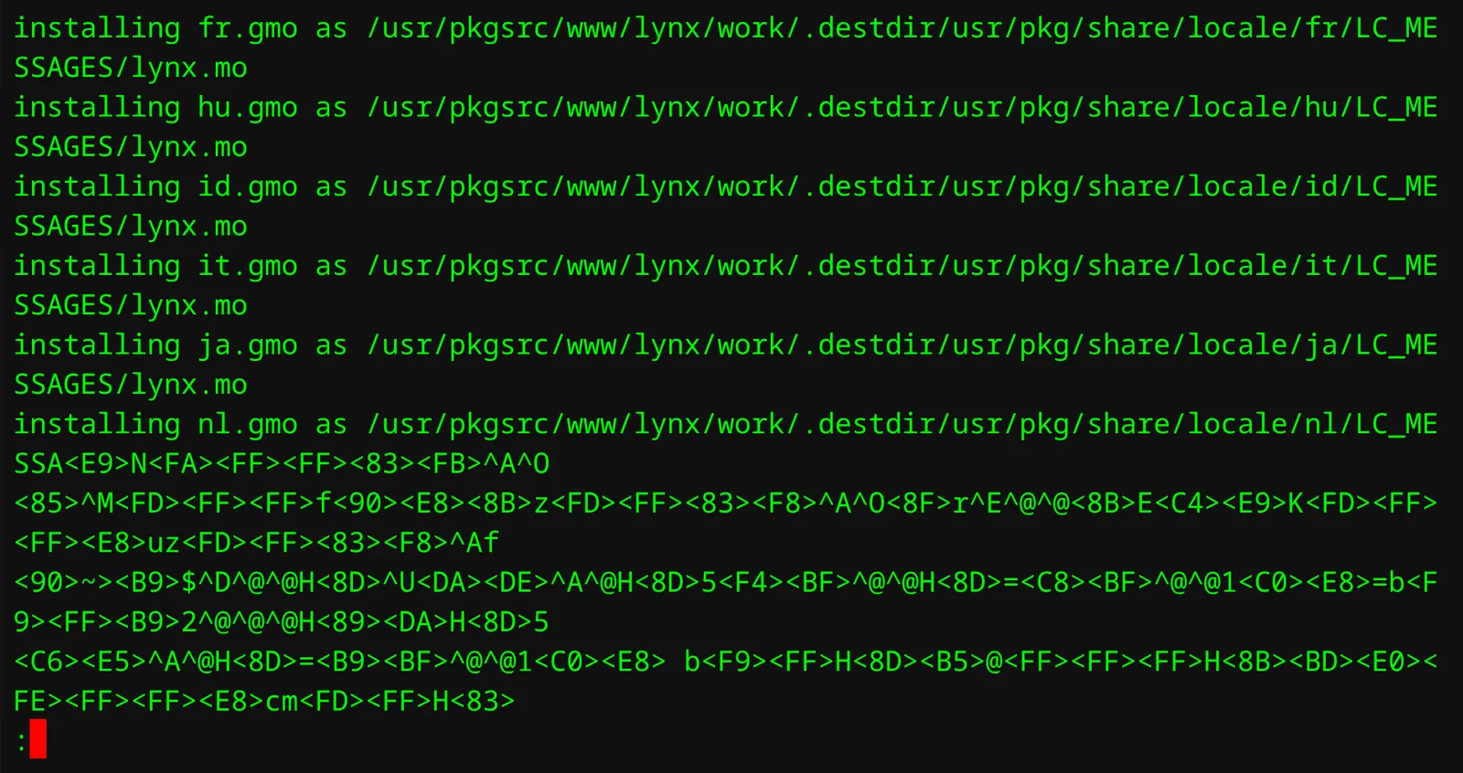

    For whatever it's worth, the context here involves the entire VPS file system recently having been restored from a backup as a way of checking the VPS' ability to backup and restore and as a way of reverting a recent extra project.
    The crazy fun compile output shown above seems to have resulted from a restored file system fault injecting binary input into the terminal and the terminal attempting to render the binary input as text. Or, at least, that's a guess.
    • Does anybody have another idea about how the crazy terminal input might have happened?
    • Does anyone have an idea about how the filesystem issues mentioned above might have happened?
    As you can see above, the filesystem issues seem to have been fixed by fsck, and the VPS is again running great! So,

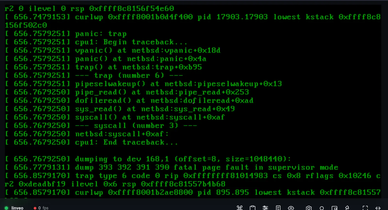

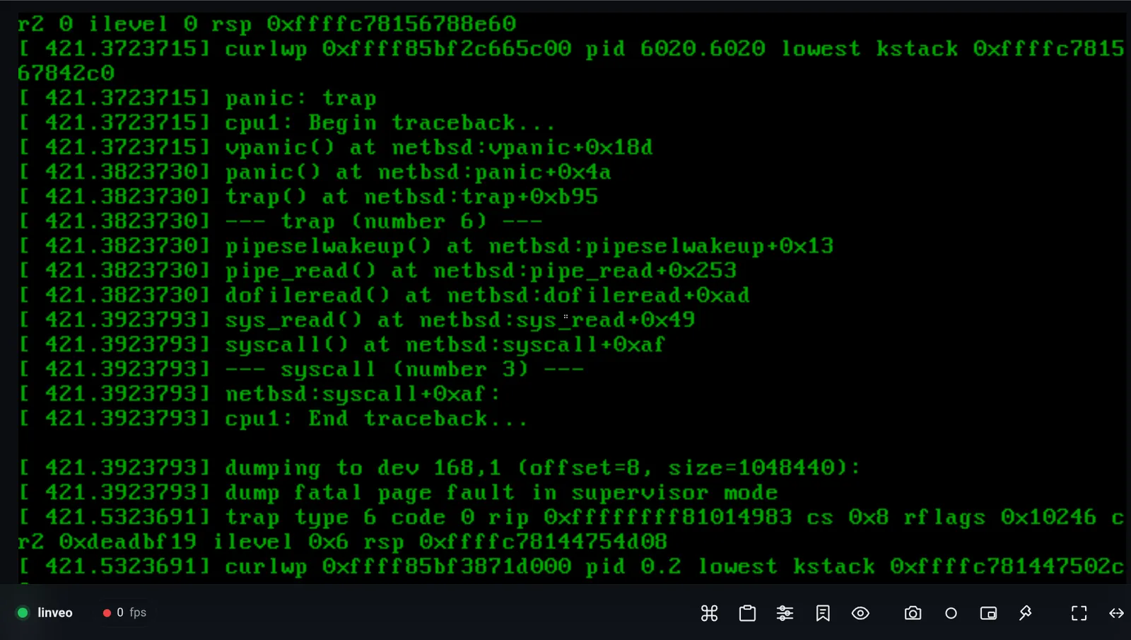

    • There were a couple of recent kernel crashes. Please see screenshots below. The VPS' running kernel couldn't survive compiling a new kernel, so I downloaded a new one from nycdn.netbsd.org. NetBSD's amazing raistradh@ fixed the kernel bug without having been able to reporduce it. Haha, I thought about offering him access to this VPS since, at the time, the kernel reliably would crash within about ten minutes of starting a recompile. I started looking into saving crash dumps, but I haven't got very far. In the few years recently and the few years previously following NetBSD-current, this is the first time that NetBSD has shown me its ability to crash.
